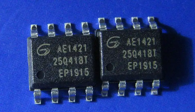

Hi flashrom community!
Long time no see. Just want to report success on probe & read of
GigaDevice GD25Q40(B). The chip itself has different markings; 25Q41BT,
as in
https://ae01.alicdn.com/kf/HTB11jcQJVXXXXaeXVXXq6xXFXXXg/FREE-SHIPPING-SOP8…,
which points which is probably same or similar GigaDevice SPI flash (?)...
The chip is found on PowerColor RX5700 ITX graphics card, and according
to the read ROM contents, reading was successful.
I do not dare to try erasing/writing, as this card is too damn expensive
to risk it...
R,
